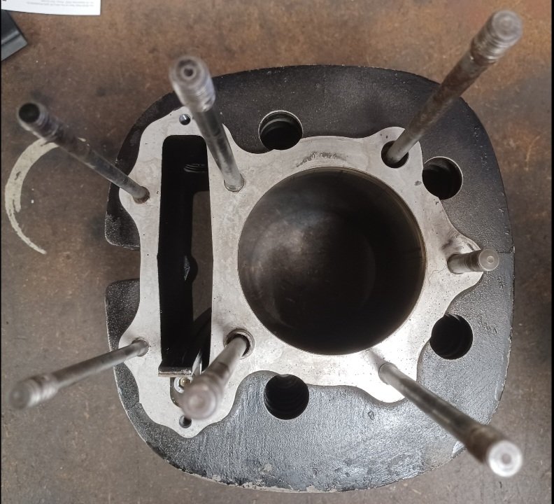

...markant an meinem Zylinder ist die Ausführung im Bereich des Steuerkettenspanners und die durchgehenden Versteifungsrippen vorne und hinten.
Theo, sieht das beim JPX auch so aus? Der Rayer scheint von der Form etwas anders auszusehen... :roll:

here are two Rayer and a JPX (in the middle)
the foundries are totally different.

...here some more pictures of the Nikasil JPX:

Beitragvon Pablo » Do Jan 19, 2023 18:55
Yes it look very similar...

Beitragvon Pablo » Do Jan 19, 2023 19:44
we do not see well on the photo if it is a shirt reported or if it is in one piece.
and there is no fin reinforcement on the spark plug side.
Pablo

Hi,
Can you measure the inner and outer diameter of the sleeve?
in fact it is very likely that it is a 3DM, painted black...

Hi again,
the shirt has an outer Diameter of 103 mm and a length of 52 mm from the bottom surface. As the former owner of the motor told me, the bore was original 93 mm, but was increased by Kedo / Grossewächter to now 95 mm.
As I have two 3BM Cylinders here, I can definitively say, that it is non of these cylinders.
