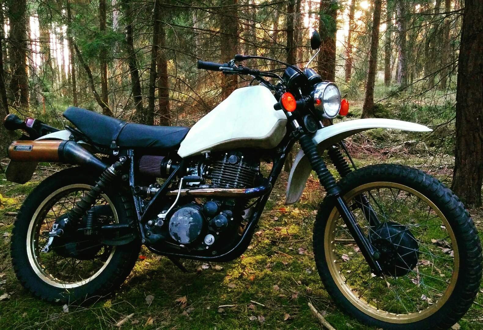

Hi XTler! ;)
Wollte euch mal wieder ein paar schöne Bilder da lassen :)
2r8F9rTBenJR3NJww7tXib1rakcnLkz8HVxZo9BVAk1RR4m6rawEJCoWMBFa5X3eKVKM8cTtZqxqCRzaCq49VYt6RCG438AHHbTpbUQx3D7qtjZjMMKz4Fp1Ny48ACC7Q.jpeg
2r8F9rTBenJR3NJww7tXib1rakcnLkz8HVxZo9BVAk1RR4m6rawEJCoWMBFa5X3eKVKM8c58Nu3dqf1nFqSQ5dRDiF8bUC5qwjAAY2uUxeEiJyNYPzptcpSBD5PyQgNZk.jpeg
2dk2RRM2dZ8gbkvz1yNBypLpwUHBnasMpK1zPunuGpAtGE4RyJsmbPiAXJA4ZyZo3QmxrM5o545J2wMx9RcYDVvi8tubugGDBPVFUgQ13qFxUmjpF4qCLh7xgfQjYqAC6NaMZxRBRuafjxjVPo84YHHyieFDqAEpw2y4m7Ftwp.jpeg
Greets Jan
