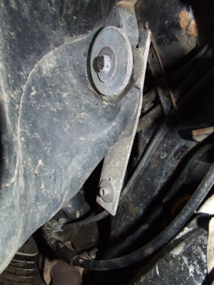

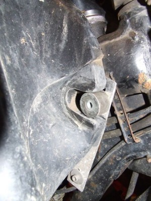

Don't worry, the tank fits on the frame very well.
I do have a picture ... but not in the snow:
My mountings also look very selfmade.
You should be able to build some yourself. Just go ahead.
The front one is very similar to the one for the 20 liter Acerbis gas tank.
You only need some big rubber parts to push the tank on.
In the back I only do have a simple aluminium plate.
Take care that you so not take screws too long in the back ...
Good luck!

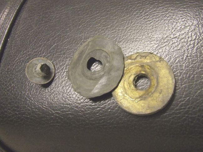

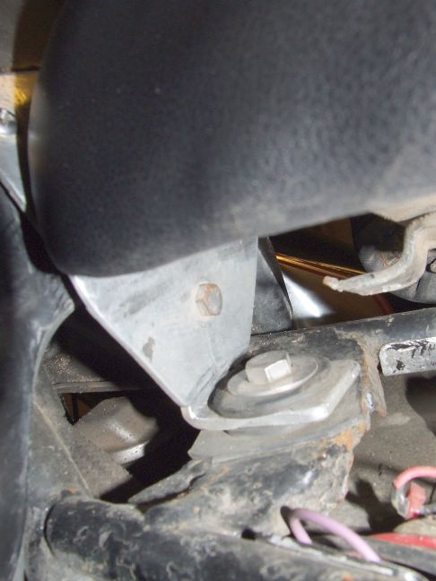

Hi,
Had no time for a ride in the snow.... :(
So the pictures were taken in the darkest corner of my garage..hope you are able to see something helpful anyhow. Its quite simple.
Don't forget to put some rubber sheet between tank and frame.
