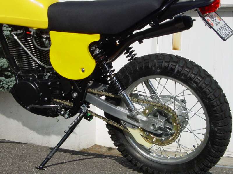

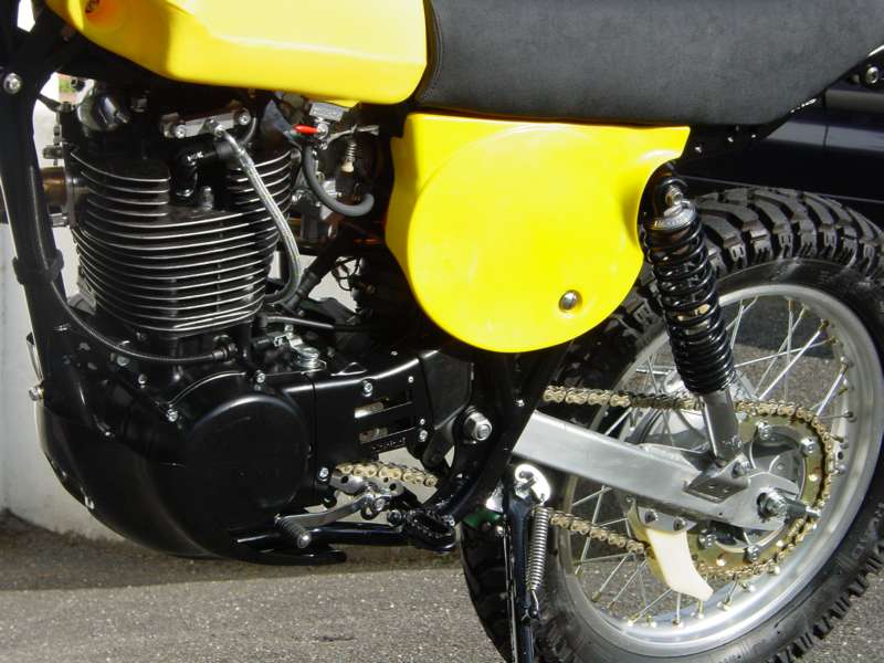

I have an aluminum swingarm in my XT500. The chainguide is missing from that swingarm. That was never a big problem but since I'm going to fit taller rear shocks the chain will be a bit looser when the rear is fully extended. So I'd like to install a chainguard.
I had a closer look at the swing and I found the text Profab on the crossmember, just in front of the rear wheel. The text is in thick, large letters and is pressed from the inside-out
After some searching (also on this forum), I've found out that Profab is a wellknown and highly sought after swingarm for the HL500. Anyway.. allthough my swingarm looks a bit different, I still believe that it is a genuine Profab swing.
HL500 swingarm:
My swingarm:
Does anybody have an idea where I can find a chainguide for this swingarm? Profab itself does not have a website but maybe someone knows where to get parts for these swingarms. An alternative is to modify an existing chainguide (e.g from a KTM EXC or so) by only using the nylon part and folding a thick aluminum plate around it that fits my swingarm.

043A
Beiträge: 373
Beitragvon 043A » Mo Mai 14, 2007 20:06
Hi,
i`m afraid HL500 is not the right way to look at.
As far a i know the ProFab (also WhiteBros) swingarm was mainly used as a aftermarket tuning pice for TT500 and XT500.
You have to look for these bikes:
this is a WhiteBros Swingarm , looks simular to your Profab
or take look at these TT500 orig.swingarm
by the way: why don`t make the chainguide the way the bike behind yours have ?

Thanks for the information about WhiteBros. I did not know that. It looks exactly the same as my swingarm
Great eye for detail! That is indeed my KTM behind the XT. Today I took a closer look at the KTM chainguide and I think that I can make it fit but it'll take quite a bit of modifying. But it is a possible solution

Beiträge: 162
Wohnort: Safnern
Beitragvon XTtracer » Mo Mai 14, 2007 22:51
Hello
as you can see I'm using also this very fine white bros swingarm. As a chainguide I'm using a common common white plastic motocross guide which I adapted a little bit. As chaintensioner I took the older XT 500 tensioner from the 77/78 model.
Good luck!
