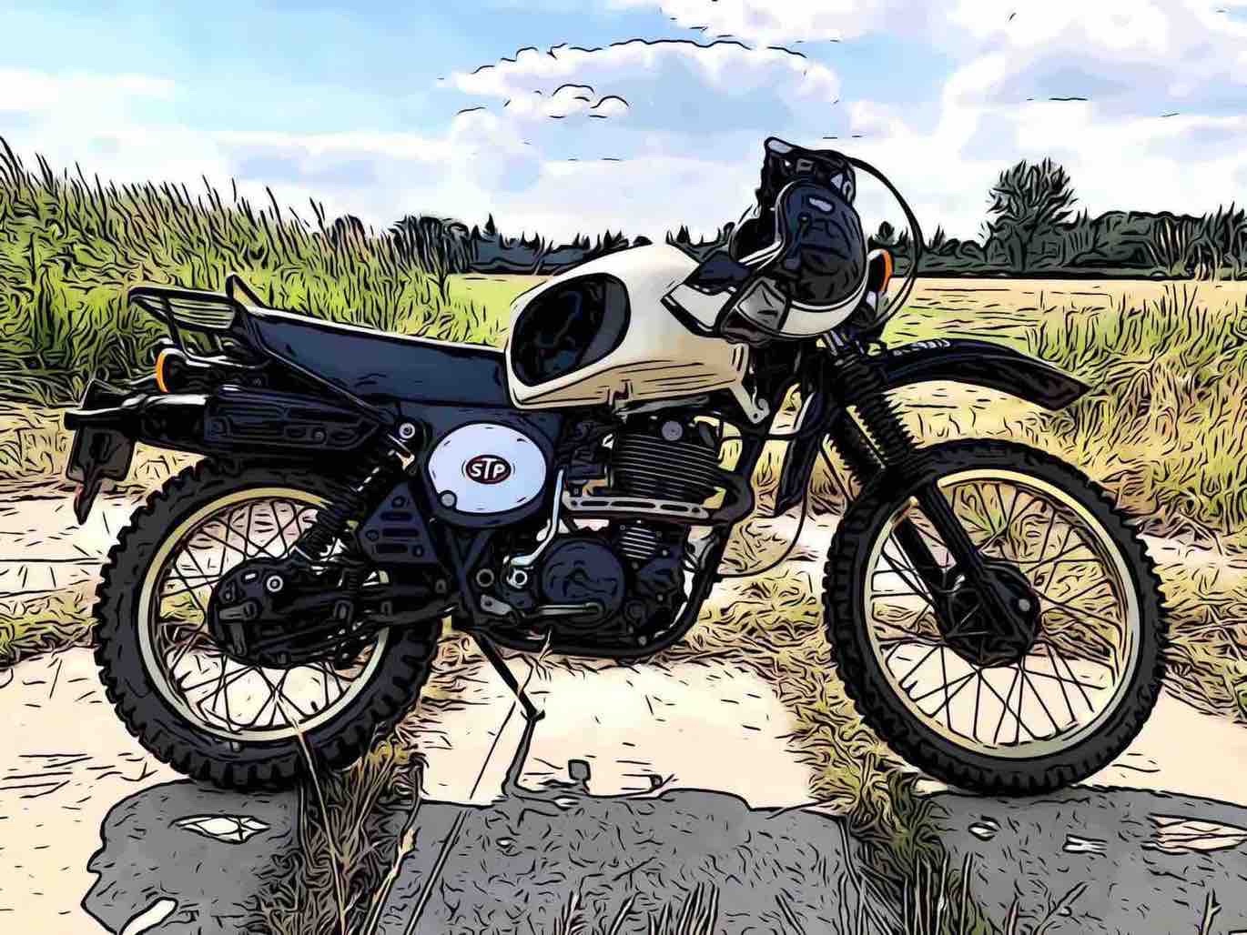

Beitragvon Steely Dan » Sa Jun 26, 2021 17:10
