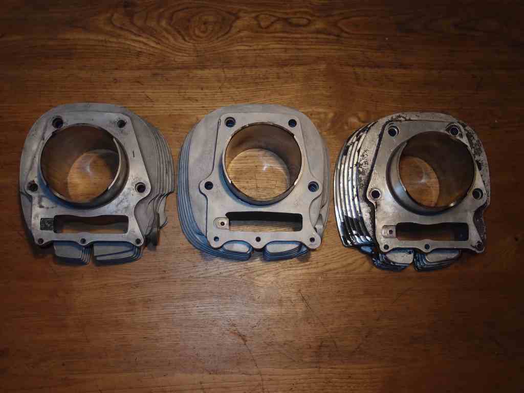

Thank you for the photos,
indeed it strongly resembles the JPX, fins above the chain tensioner, reinforcement between fins ....
here is a JPX (in the middle) and two Rayer....
the fabrications between the two are completely different.
i will ask around about JPX nikasil....

...nice photos, thanks!
The DreiBuchstabenMann-cylinders are very reliable, but the machining by 3BM is quite poor, the Pami configuration together with a CP or JE piston is much better.
