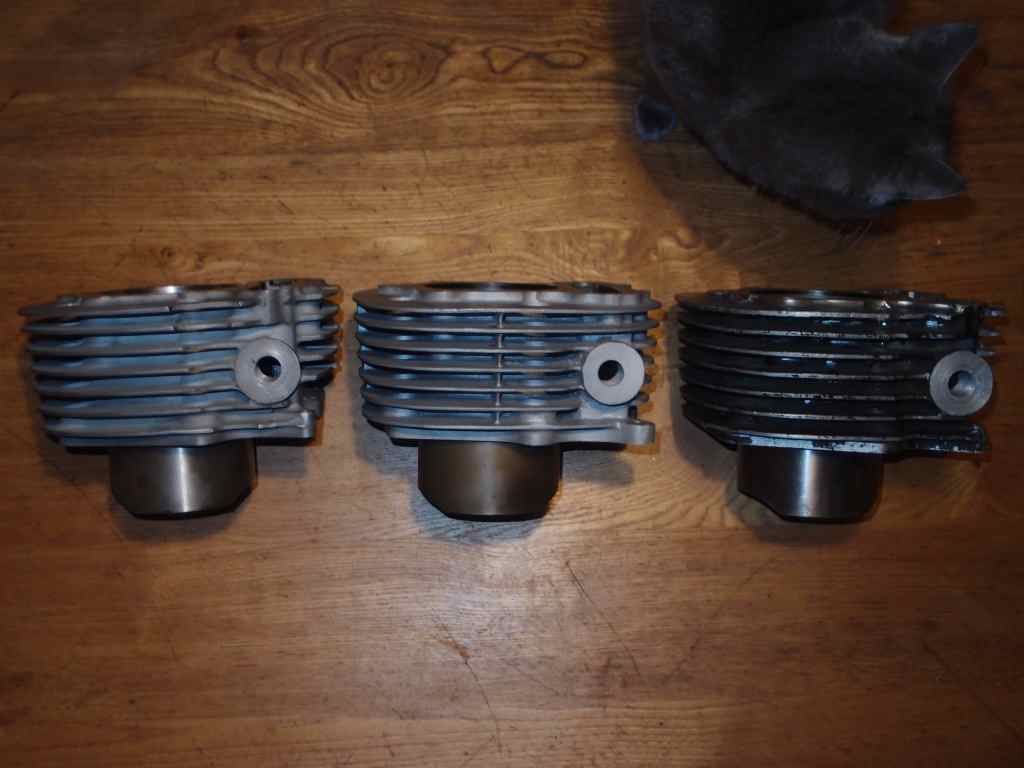

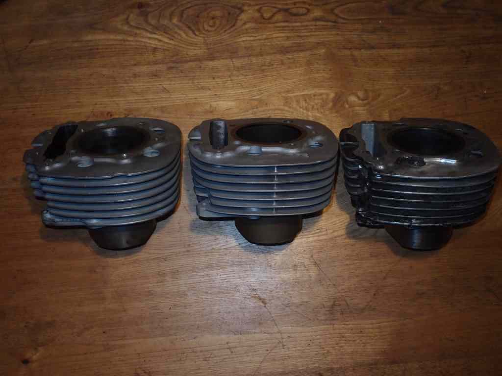

...here you find some pictures:
https://www.xt500.org/68eustw03ihkmsez/ ... er#p162981
But I can send you some more if you like.
I'm sure it is a different casting compared to the DreiBuchstabenMann part.
Hans are you sure about this? I've never heard about this. I believe he used his "own" casting and also sold these to others.

and what about the solidity of these cylinders..
- Beiträge: 27
- Registriert: So Jan 15, 2023 18:04
- Beiträge: 2364
Re: Piston 93.5 Wossner
...nice photos, thanks!
The DreiBuchstabenMann-cylinders are very reliable, but the machining by 3BM is quite poor, the Pami configuration together with a CP or JE piston is much better.

Hi
do you have more pics of the cylinder?
above and below...
thank you
above and below...
thank you

...I posted some new pictures here:
https://www.xt500.org/68eustw03ihkmsez/ ... 60#p166560
In my opinion it must be a JPX...

In 2011 I bought a Mahle piston which was finished by Helmut Wahl to 93.5mm and prepared for 88mm stroke without the need of an additional cylinder gasket (2mm).
It has a complete weight of 476g incl. clips, rings and piston pin.
Cylinder is definitely RAHIER.

Mr Rahier Gaston was a pilot.....
Mr Rayer Christian, a kit maker....
in terms of the longevity of the kit and its sobriety in oil is strongly due to the famous U-flex scraper segment of a special technology .... and unfortunately not found nowadays ...
but the cylinder is not a Rayer, far from it.
maybe a JPX but I have doubts if it is not a reported shirt....
namely mr Rayer is still selling 2 or 3 kits which will have a 94mm Wossner piston...
and shirts...

- Beiträge: 2364
I'm only talking about the cylinder itself, whoever casted them ...NOTHING he does is reliable...
Cheers,
... not the machining...
I've never heard that one of these cylinders cracked...
