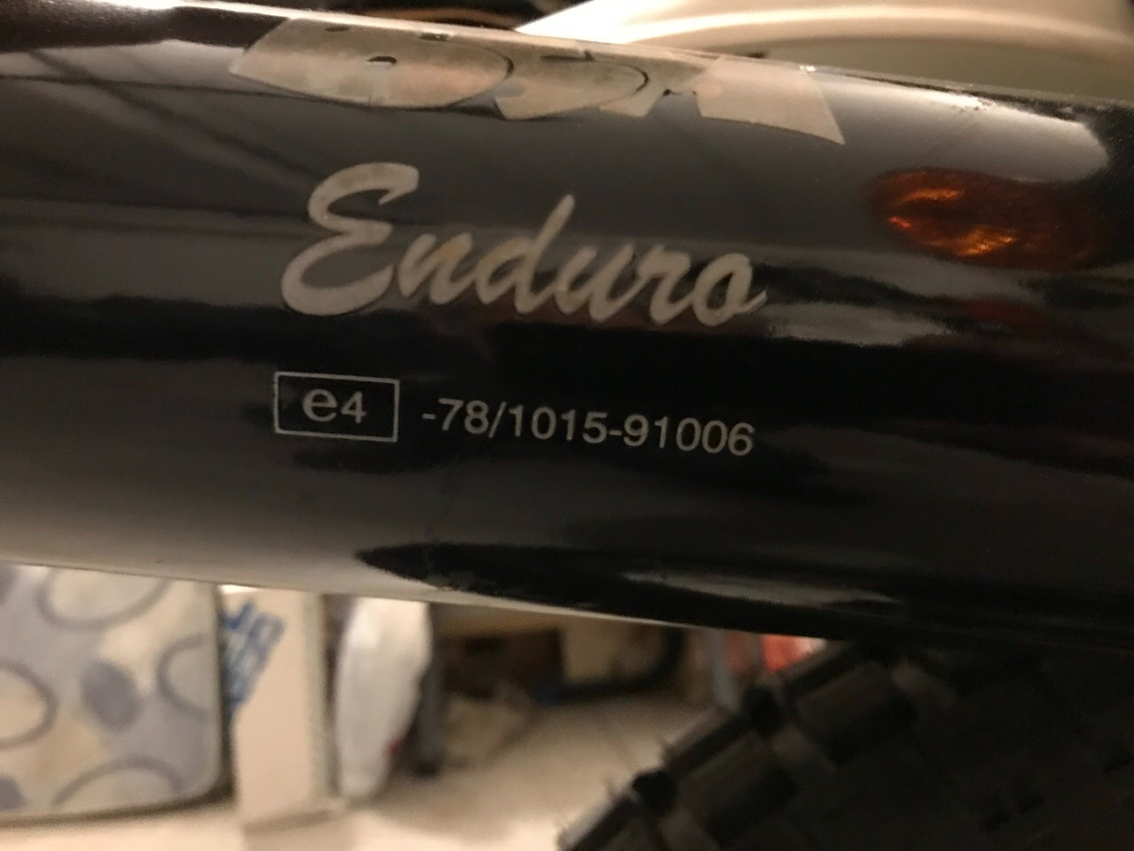

BSM Enduro number:
https://dl.dropboxusercontent.com/u/914 ... G_1419.jpg

It is an replacement silencer from BSM Enduro (e4 -78/1015-91006) and even if it is e-marked I am required to provide technical doc that prove that it is suited for an XT500 and copmply with the noise requirements.
